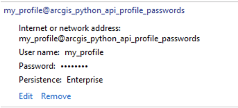

Hope this is still useful. As a workaround, you can bypass the profile file and  retrieve the credentials from the Windows Credential Manager. When you create a profile using:
gis = GIS(url="https://xyz.maps.arcgis.com", username="username", password="password", profile="my_profile")
 a corresponding generic credential is created in the windows credential manager with the profile value as the user name. The Internet or network address for the credential will be in the format of profile@arcgis_python_api_profile_passwords:
You can use keyring to retrieve the stored password and connect to your org:
import keyring
from arcgis.gis import GIS
profile = "my_profile"
network_addr=f"{profile}@arcgis_python_api_profile_passwords"
pwd = keyring.get_password(network_addr, profile)
gis = GIS(url=<agol_url>, username=<agol_user>, password=pwd)
