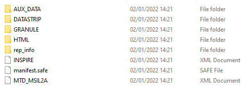

I downloaded a Sentinel-2A tile. The folder structure is shown below:
I want to open this images on my ArcGIS Pro notebook. I've tried with rasterio and gdal but it doesnt work. So, I tried  with Raster() but it doesnt work either. I might be doing something wrong.
