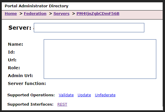

What I need is the URL for the Server, not the admin endpoint. Looks like the list() method does not provide this. Looking in https://portal.domain.com/arcgis/portaladmin/federation/servers/servername I can see the URL attribute.
Can I get the server URLs using the arcgis python api?
