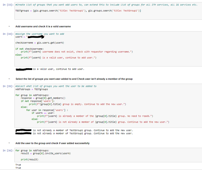

This is the code I am using:

I tried testing this and think there is a slight formatting issue within the code.
At the end we are passing the username into the invite_users method directly as a string.
for group in AddToGroups:
    result = group.invite_users(userN)
    print(result)
Instead we need to pass this through as a list based on the sample in the documentation.
    result = group.invite_users([userN])
    print(result)
