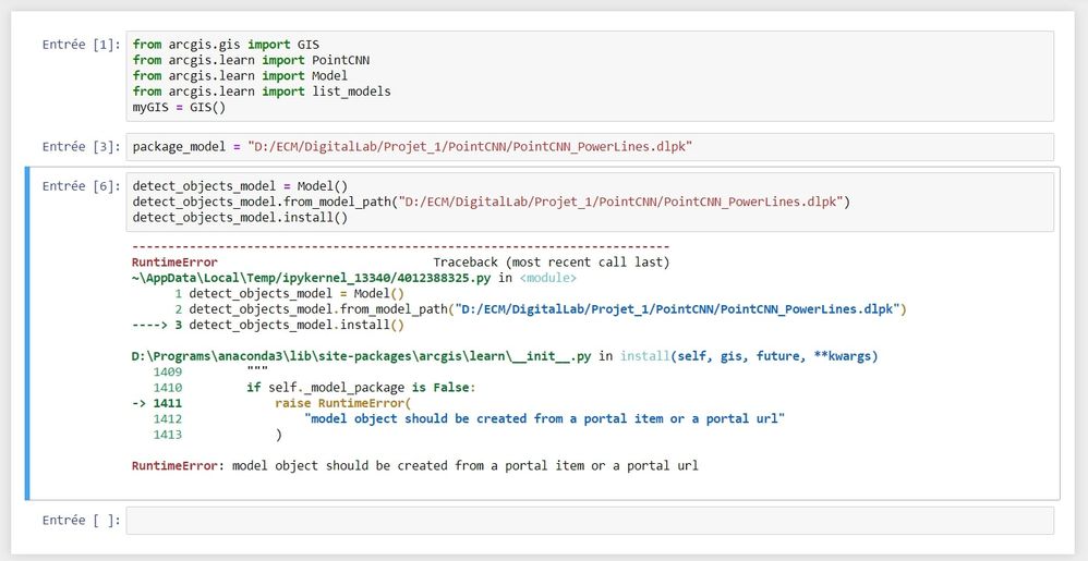

Hello everybody,
I'm working on a deep learning project and I needed to use a trained model. But when i want to install it, an error shows up that i don't understand.
RunTimeError : model should be created from a portal item or a portal url.
Can anyone explain me the error and tell me how to fix it ?
Thanks for your attention and for your help.

Hi @mehdihamdoune ,
It should work if you first add the dlpk file to Portal/AGOL from Content > Add Item then get it in your script via item id as follows:
detect_objects_model_package = gis.content.get(item_id)
detect_objects_model = Model(detect_objects_model_package)
detect_objects_model.install(gis=gis)
I hope that helps.

Mehdi99
Thank you for the response, it works.
