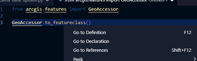

I use VSCode, but I'm sure any decent IDE does the same thing:
Right-click or hit F12 to "Go to Definition". That will open up the specific python file to the line which defines the function/class/method you've clicked on.
From there, you can browse further down and see what is being referenced by that code.
Note that you cannot make changes to the built-in ArcGIS Pro files, but if you're working with your own python env, you can make some tweaks to the code, like setting "sanitize_columns" to default to False, or to code in the ".copy()" so as to avoid modifying the input frame.
Of course, should you go that route, know that you're stepping outside of the accepted use of the code, but if you find it to be a useful improvement, suggest it as an enhancement on GitHub!
