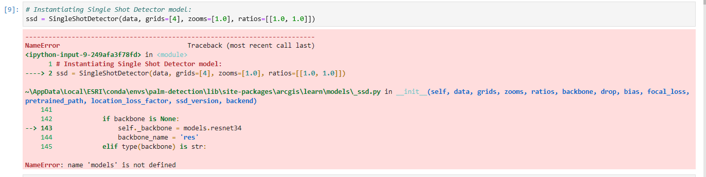

Hi,
I am new to Deep Learning and arcgis.learn module. I am following the case study "Palm Tree Detection" . While Running the code the below Error is occurring. How can I Resolve this Issue?
arcgis.learn object detection‌deep_learning arcgis-api-python palm tree-detection‌

From a purely python perspective it's not understanding your class name 'models'.
Try pytorch.models.resnet34 or whatever module you imported.

But I Just imported SingleShotDetector function from arcgis.learn. Which is having the modules from pytorch, fastai and scikit-image

If it's just being passed as a parameter, try = 'RESNET34'
ManojG
I tried this as you suggested. But the Errors raised at the time of importing packages. so I Undo the changes
