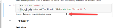

Did you paste in the item ID when prompted, then hit enter and continue running the code?

I have had success using the notebook here.

Thank you so much for that clarification. I was trying a lot of variations to get the notebook to work, but that did the trick. This is a great tool to have in my kit!
