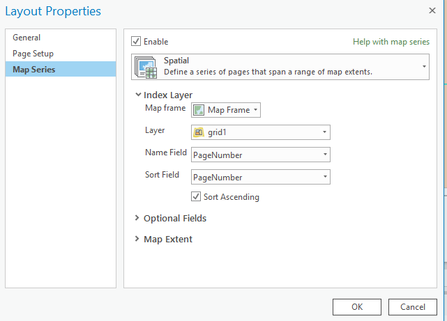

So is the hangup here that we need syntax not only to enable the mapseries, but also to inject any required properties? For example, the ArcGIS Pro tool dialogue insinuates that the map frame, layer, name field, sort field are all required.

I was not able to resolve this issue using Python, but I was able to workaround it by enabling the Layout Map Series using the ArcGIS Pro interface prior to running any scripts. Saving the Layout with MapSeries enabled carried over to the import process used within the script. This worked every time I ran it across multiple sessions and using multiple projects. I'm hoping to find a way to manually write the "enabled" property in the future, though.

I have not enabled the Map Series on the project before running any scripts because, from my understanding, enabling the map series requires an index layer. In my case, I'm not creating this layer until my script has already run (adds the user's shapefile halfway through), so I have nothing to choose from for this required layer if that makes sense.
