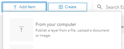

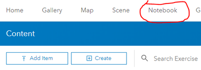

If you're using AGOL, you already have Notebook available and you can add a notebook as an item from your pc onto AGOL:
or create a new one. Once it's been added/created you can share it to anyone or to a specific member just like other items.
If you're using Portal, first you need to have Notebook Server installed in Portal (ArcGIS Enterprise). Then similar to AGOL you will have different sharing options.
