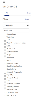

That's what I'm after is our stuff on the Hub site: https://hub.arcgis.com. Is that possible with the Python API? That's my question. We have 900+ items.

Yes, unless I'm completely missing something I can not access the content on our https://hub.arcgis.com page using any module or submodule.
