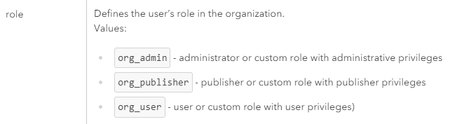

There are three possible values under role property:
org_userorg_publisher and org_admin
The only explanation for what you get is that custom roles are named as 'org_admin'.

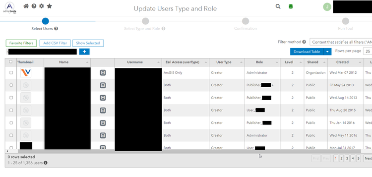

If I use this admin tool I can read all the users
And it reads it correct... When Cant I do that via python
