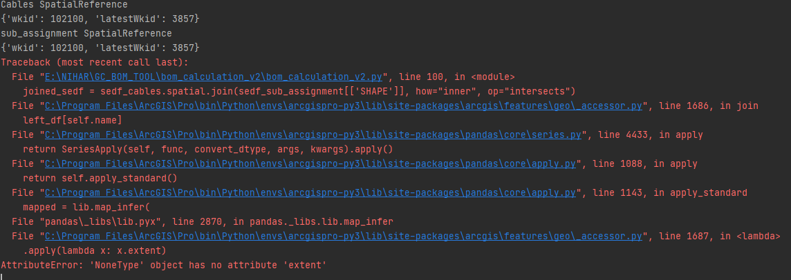

I want make a spatial join with my two spatially enabled dataframe. But while doing a join between the two dataframes. I got below errors.
joined_sedf = sedf_cables.spatial.join(sedf_sub_assignment[['SHAPE']], how="inner", op="intersects")
Can anyone let me know why this error appear and how i will be able make a join between the two dataframes where one is polygon and another is one is a line feature.
