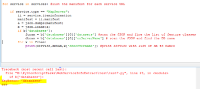

This script print out a few mapserver and then return this KeyError message...
File "Q:\Aqua_ArcGIS\WebServiceInfoExtract\test\test7.py", line 23, in <module>
fcnam = b['databases'][0]['datasets'] #scan the JSON and fine the list of feature classes
KeyError: 'databases'
Have any idea?
RobertAkroyd1
Looks like the JSON for that service did not include a "databases" element, so you should check for that in the code first, e.g.
     b = json.loads(a)
     if b['databases']:
HaThach1
I got the same error after updating the script.

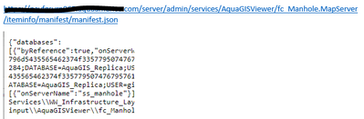

Do you get a list of services from the hosting server?
Have you manually checked the JSON manifest through Server Manager for a specific service?
(Should look like: https://resources.arcgis.com/en/help/server-admin-api/serviceManifest.html. Gained through Server Manager) Example URL here: https://portal.domain/server/admin/services/ServerFolder/ServiceName.MapServer/iteminfo/manifest/man...
HaThach1
I didn't get pass this error
AttributeError: 'PropertyMap' instance has no attribute 'portalProperties'
As for the JSON manifest check, I was able to constructed the URL from your example and see the JSON manifest of a specific service.
