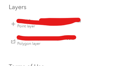

The results in the ArcGIS Online portal shows 2 layers in the view (WRONG!):

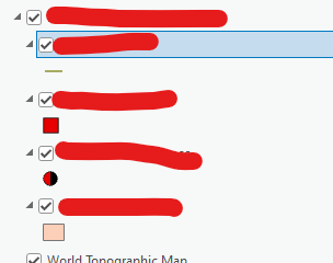

The results in the REST catalog shows 4 sublayers (RIGHT!):

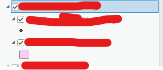

Adding the view to ArcGIS Pro shows only 2 sublayers (WRONG):
However I can add the sublayers one-at-a-time by the sublayer path:
What's going on here? I need all four layers.
