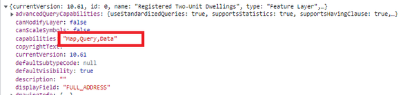

I took at look at one of the REST endpoints behind one of the layers ('Registered Two Unit Dwellings') and it did not have the EXTRACT capability enabled. I suspect this is why it is not working for your.
