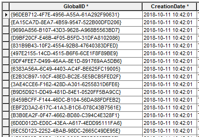

Some screenshots:
Export as File Geodatabase:
Export from script (notice 'GlobalID'):
Export from script (notice abbreviations and capitalizations):

Thanks for your response. Your suggestion almost got me to where I want to be though I'm still having issue with abbreviations ('FEED' instead of 'Feeding') and blank attributes in the output (shapefile) feature class, though I'm thinking that this is what is going to happen no matter what if converting a file geodatabase feature class to a shapefile. (I just did the feature class to shapefile conversion in ArcMap and got the same results, so I guess this is the results I'm stuck with.)
