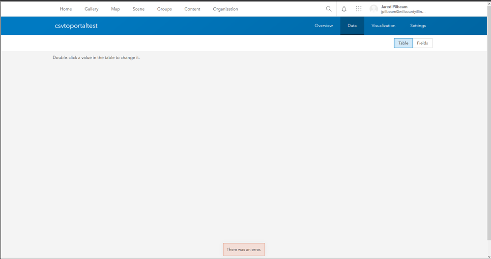

It actually published this time, but on the data page of it it says "There was an error". And the weird thing was, just after I did this the server was down with some 500 error?

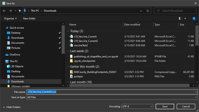

I found out it has something to do with the encoding of the CSV file. I was able to publish the CSV after completing the following steps.
1. open the CSV in a text editor (I used Notepad).
2. use a .csv file extension type --> Save as type: All Files --> Encoding: utf-8
3. try publishing to Enterprise Portal with this:
from IPython.display import display
from arcgis.gis import GIS
import os
gis = GIS('Home') #uses current Notebook as workspace
csv_file = r'C:\pathto\your.csv' #path to CSV
csv_item = gis.content.add({}, csv_file) #add CSV to Enterprise Portal
display(csv_item) #display it here
#location parameter needs to be set to "none" when publishing to Enterprise Portal
params={"type":"csv","locationType":"none"}
csv_item.publish(publish_parameters=params) #publish to Enterprise Portal
This is not the fastest workflow. If you're able to set the encoding to utf-8 back when you originally create your CSV then that would be better.
