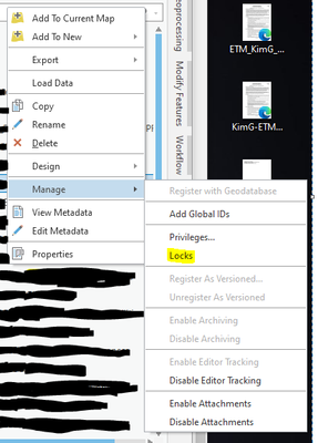

Is the data coming from a service, or from a file geodatabase, or from an enterprise gdb...?
If you open the Catalog Pane and right click your feature class that you are running the tool (in python) against and right click it and select "locks"... does it report any locks?
Might you have anyone else viewing or editing the same data at the same time, or have a service that is referencing the data?  Just trying to eliminate things can can lock a dataset.
