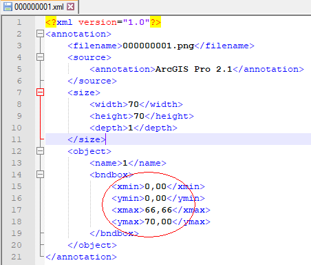

On my system, the "Export Training Data for Deep Learning" Tool seems to export label xml files with a comma as decimal separator see image.
However, the ArcGis Python API function prepare_data expects float values to be separeted by a dot.

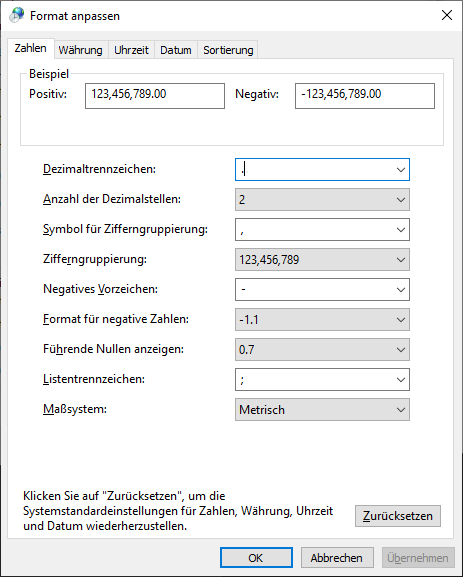

My Windows 10 region format is already set to use . as decimal sign:

What is your OS region setting? Some regions use commas instead of periods as decimal points. Maybe it's related to that? You can check in your OS settings.
PhilippZacharias
My Windows 10 region format is already set to use . as decimal sign. See image in main post.

So I found out that I have to change my whole windows 10 system language setting from german to english, so that the Export Training Data for Deep Learning" Tool finally creates xml label files with "." float values, instead of using ",".
