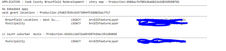

I'm in the process now of cloning web mapping applications and dashboards right now using the ContentManager.clone_items method because I want to now clone those apps and pass the new web map ids that I copied to the cloned app. I'm running into a problem though with the item mapping. I have tried several times to pass the item_mapping parameter the dictionary of source (old web map ids) and target (new web map ids) but the result is a clone of the app with the old web maps: here is my code below. You can see that the ids for the web maps persist rather than updating to the new ids.
This is a StoryMap app
item_map = {'2fa027839c63473094f538d029a17f17': '4301017941324b35b157f54114877481', 'dd161c2a532a491987426ec3912840d8': '7ff1b8c0c2a04b5992893bda146f6ef2'}
copied_embedded_app = content_manager.clone_items([embedded_app], folder_name, item_mapping = item_map)
print_app_inventory(copied_embedded_app[0], gis_source)

Hi Simon, thanks for your response. I ended up doing the get_data() option for some of the older stormaps and that seemed to do the trick. In addition to that I also had success using the get_data() method to find the dependencies of my apps and clone those first then clone the actual app and pass the item_id_map to the clone items method. That seemed to work.
