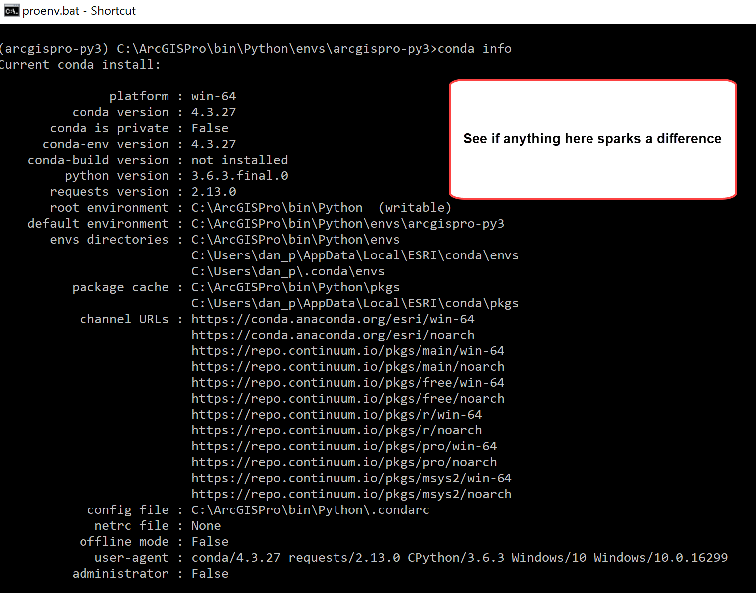

When you run conda info from the active arcgispro-py3 env, what do you see? What is the root environment?
condaInfo
DanPatterson_Retired
MVP Emeritus
Mine is different, perhaps the reason, but have a look
PhilLarkin1
Yes, I'd expect the root environemt to be C:\ArcGISPro\...
I need to figure out how to successfully activate Pro envs when I have Anaconda installed on the same machine.
MVP Emeritus
that is my root C:\ArcGISPro\...
The default root is for multi-user environments and is somewhere in the c:\programs-something locale
I do have python 3.6 installed hence some of the other packages are updated
