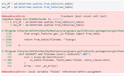

Hi,
I've found what i think is a bug in the API. When I try to trasform a dbf table to a dataframe,
it returns the error:
DanPatterson
MVP Esteemed Contributor
It has been noted before
Solved: pd.DataFrame.spatial.from_table() is loading colum... - Esri Community
specify your fields
