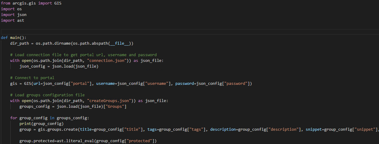

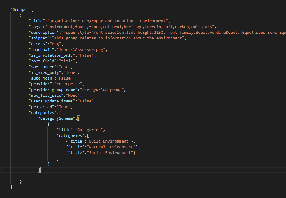

My portal groups configuration (title, etc) is stored in a json file (see below for example)
and I'm reading & loading using the standard import json lib, etc.
The above code works very well in creating the group & setting the Delete Protection checkbox.
I added the following line of code and the script still runs with no errors, etc
group.categories.schema=group_config["categories"]

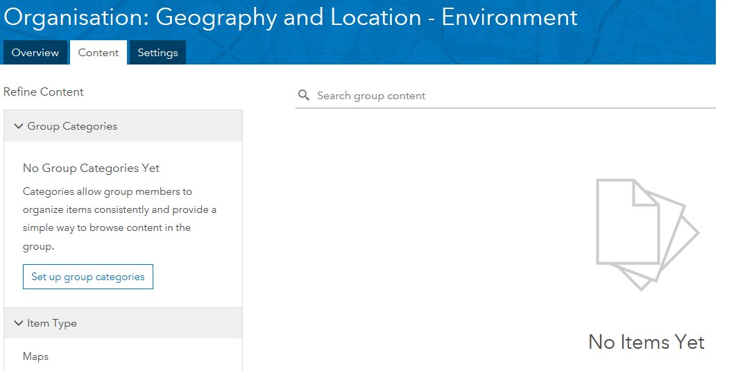

But the Category section for the Group is still blank as you can see because the 'Set up group categories' button is present
Do I have to assign the category a different way or is there an issue?

Hi everybody,
I logged a support call and Esri Inc found this issue to be a bug (BUG-000124536)
