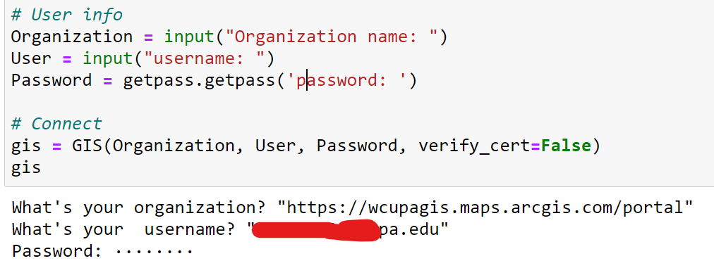

I'm trying to access my schools AGOL organization from Jupyter notebooks using:
But keep getting error 400, can not generate token/bad username or password.  I have tried all the variations on this I can think of (capitalization of my username as it appears in AGO, adding /portal to the organization url, etc) but nothing has worked.  Is it obvious to anyone here what I'm doing wrong?

Hello,
I think the issue may be that you are appending /portal to the URL. The following should work:
gis=GIS("https://orgName.maps.arcgis.com", "username", "password")
gis=GIS("https://arcgis.com", "username", "password")
In the second option, you can enter in just arcgis.com and your username will automatically place you in the corresponding organization.
Also, it is worth noting that while signing into ArcGIS Online through a web browser or ArcGIS Pro is not case sensitive, making a GIS object through the ArcGIS API for Python is case sensitive. Make sure that you are using the username and password exactly as listed in your profile in your ArcGIS Online organization.

Tim_Callahan
Thank you for the reply Calvin.
As you suggested I've tried dropping the /portal and quadruple checking that my username is capitalized as in the profile, but I get the same error.
I think I may have identified the problem though.  When I normally log in to ArcGIS Online, I do so through the enterprise login option associated with my university.  Trying to log in via the ArcGIS login option in the sign-in window using my school credentials doesn't work.  So I guess that every time I sign in to ArcGIS Online I'm actually going through the school's system and they are passing different credentials than what I'm entering to satisfy the school login.
The process goes: open orgName.maps.arcgis.com -> choose the enterprise login on the sign-in screen -> enter my school credentials.
Sorry - there's probably better vocabulary to describe what I'm seeing.
-Tim
DavinWalker2
Hi Tim,
If you normally use an Enterprise login the login details may have to be formatted like this DOMAIN\username for example edu\tim.callahan

Tim_Callahan
Calvin,
Thanks for your help! The Oauth 2 client ID login method worked.  I would have been a very long time figuring that out.
