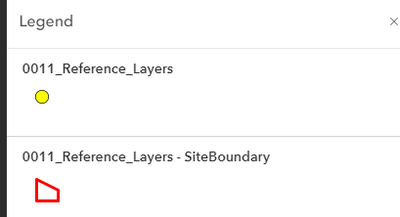

I am attempting to add a few layers from a single feature collection in to an existing webmap (Ecology_Map) on AGOL.  The feature collection consist of a point and a polygon layer:

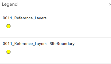

I use the add_layer function which adds the feature collection however the polygon seems to be symbolized as a point (the same as the first layer in the collection):
Code used is here - it is a script I used in Pro
        lyrsToAdd = gis.content.search(query="title:"+service_name, item_type="Feature Layer")
        extent = lyrsToAdd[0].extent
        Ecology_Map = WebMap(item)
        Ecology_Map.add_layer(lyrsToAdd[0])
        Ecology_Map.update(item_properties={'extent': extent})
In addition the Ecology_Map  extent is not changed to the extent of the feature collection.  Any ideas where I am going wrong?
