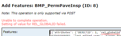

I tried to grab that Features JSON return from the query and do the ADDFeature right at REST....
Any idea what this error could be about?

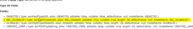

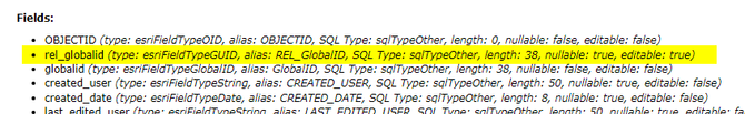

Both GUID fields just difference in Case for the field name
This is the Portal Feature Service for REL_GLOBALID
This is the AGOL Feature Layer for REL_GLOBALID

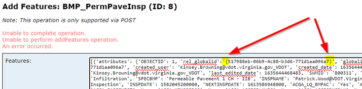

OK so I hardcoded these in there because its a GUID field { }
It ran through now I get this error?
kapalczynski
Think I might have found it... there are a bunch of fields that have a Domain of Yes and No... I am trying to pass in NONE... its breaking...
