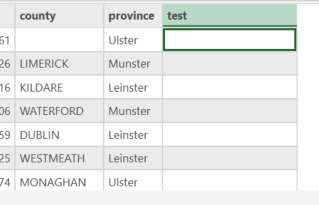

The title says is all. I'd appreciate being able to maintain null values when converting a SeDF to a featureclass in a gdb. I've used pandas.fillna() with fillers like a space before, but sometimes a null value is there for a reason, and I'd prefer to leave it null.
2 Comments
Clubdebambos
Yes please. It currently exports as empty strings (for text fields). Here is a link to the issue and current feedback: github
EricErtl
I agree that this needs to be changed.  Its another instance of the tool changing values when not explicitly defined (sanitize_columns was another instance of this).  arcpy ExportFeatures/Table honors null values but its hit and miss with executing successfully.
Another workaround our team has utilized is to calculate values with the Calculate Field tool after using to_featureclass.
