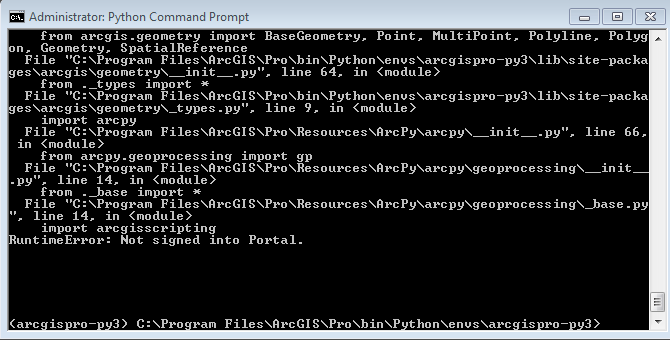

I am having an issue upgrading to 1.2, I recently installed ArcGIS Pro 2.0. I have tried to install the arcgis module 1.2 and receive an error "RuntimeError: Not signed into Portal". I then tried installing an older version 0.2 and it installed correctly. Then i tried upgrading to 1.2 and i received the same error. Is this a known issue with this new version?

Do you get this error during installation, or after when you try running a script?
Also, are you signed in and licensed Pro? At v1.2, when you install the API from Pro, you get a few additional capabilities that rely on ArcPy. ArcPy requires you to be licensed by signing into your named user licensing account. Hence you might be seeing this.

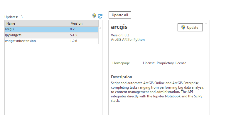

I forgot to add that part in. I also have tried to install it through the arcgis Pro package manager and it will not install. It looks like it is going to install but after the installation completes it is not installed. I assume the same problem is happening in the back ground but i am not sure how to look at the logs for the installation.
ChrisJones-Roberts
This error occurs during installation. I am signed in and licensed with my organizations ArcGIS online site.
These three will not update. and I have admin credentials which i use when trying to install through package manager and when trying to install through the command prompt.
Thanks
