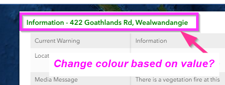

I'd like to change color of the popup title depending on the value in the field. There are four possible values.

How do I get the different color for the title depending on the value of this field?
