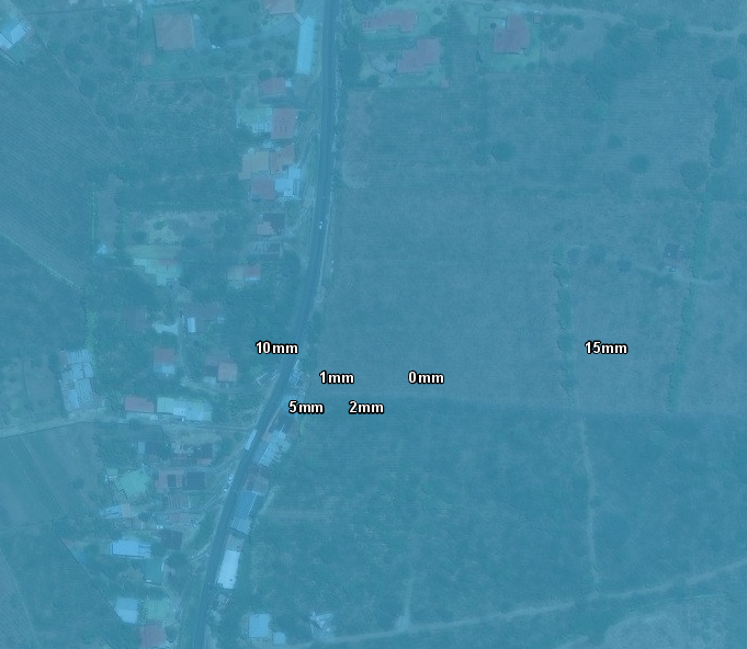

I'm trying to label an ImageLayer but all labels grouped all together:
labels all together arcgis javascript js 4.13
I'm labeling with this:
labelingInfo: [
                  labelExpression: '[Contour] CONCAT "mm"',
                  labelPlacement: "always-horizontal",
                  minScale: 2000000
                  maxScale: 1000
I would like to see only the label of the feature or features that I'm watching. Thanks for any help that you can give me!

Unfortunately, I think the issue you are seeing is caused by the data. Each feature (polygon) is labeled as close to the centroid as possible. So if there are no outlines for the features, it can appear that there is groupings when really there aren't.
Simplified sample using FeatureLayer instead of MapImageLayer
https://codepen.io/noash/pen/abbpwjN
DiegoMonge_Chinchilla
Noah thanks a lot,  I took it from NOAA and uploaded to the server with an arcpy script, seems that now they are making an overlapping of features :S,  I didn't realice about that change, now I have to solve that, thank you very much!
