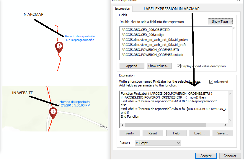

Im having a problem with a label expression in ArcMap that we have setted up.
As u can see, we added a label exp in VScript that works in Arcmap but when we go to the mapview that we made, the layer is showing the datetime in another way (not with the logic we put it the expression).

In arcmap (after the configuration for the label) it is showing in the map like in the pic 1. (Thats what we want)
But after we go to our web app (adding it as ArcGISDynamicMapServiceLayer) the label is showing a different thing (pic 2)
