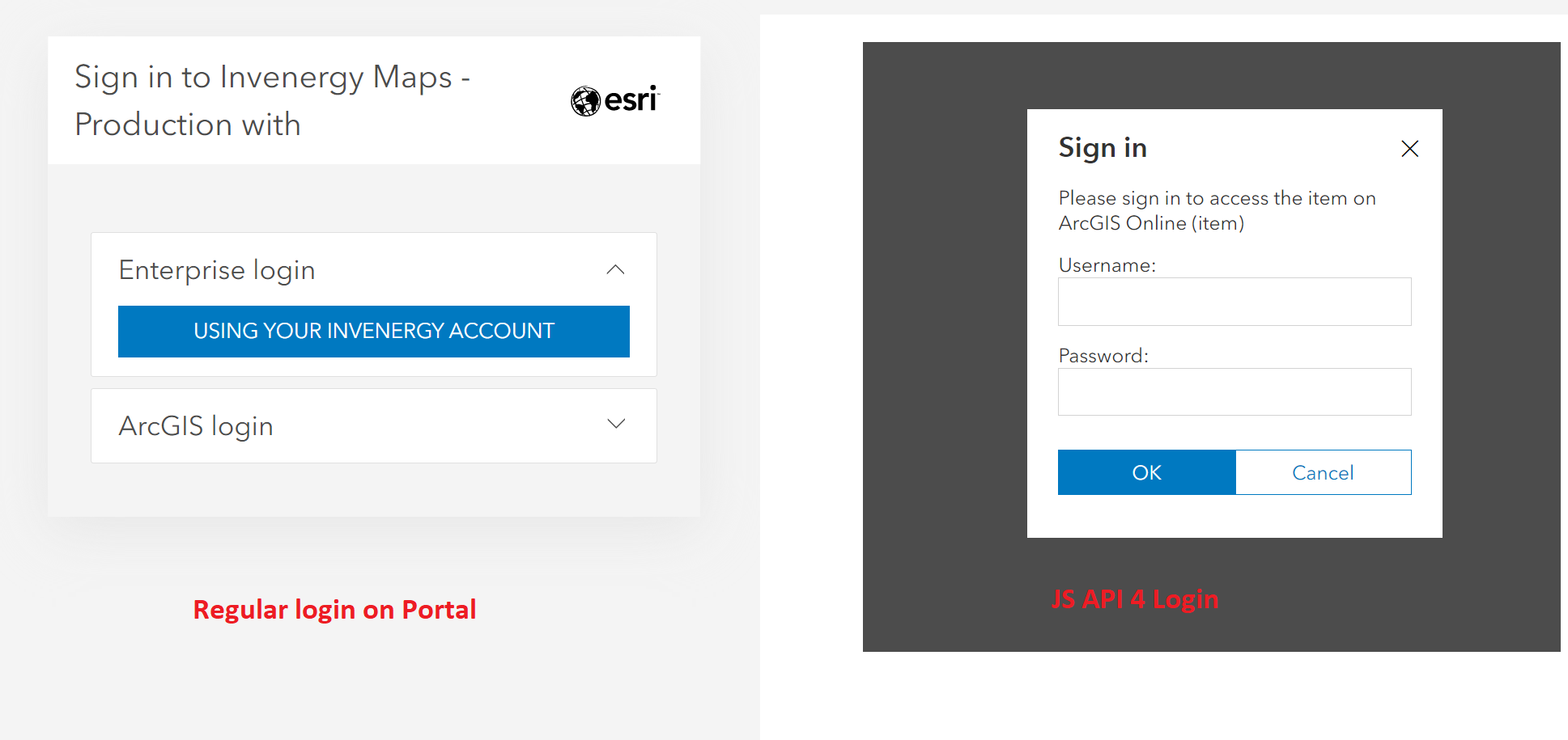

I'm trying to access my Portal items with JSAPI 4.
The code works below, however when logging in I get a different login screen that what I am use to getting. This is preventing me to login with my Okta account. (see image)

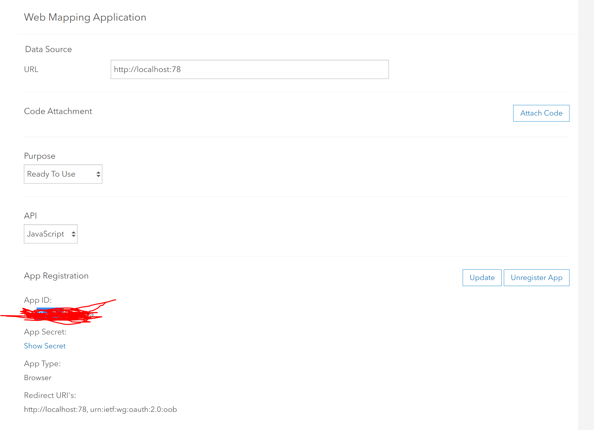

 I registered the App in Portal and copied over the AppID. (see image)
We are using Auth2.0

Hi @Anonymous User ,
What is the authentication on your Portal for ArcGIS (ArcGIS Enterprise)?
On a side note, I troubleshooted with the following sample app using "ArcGIS Online" as the portal, and the OAuth workflow worked:
Thanks,
by Anonymous User
Not applicable
Hey @KavishGhime3  thanks for the reply.
I can get it to work with my AGOL account. We have both AGOL and Portal both use Auth2.0 we use Okta to login .
I can get the simple app to work with AGOL but not Portal.
