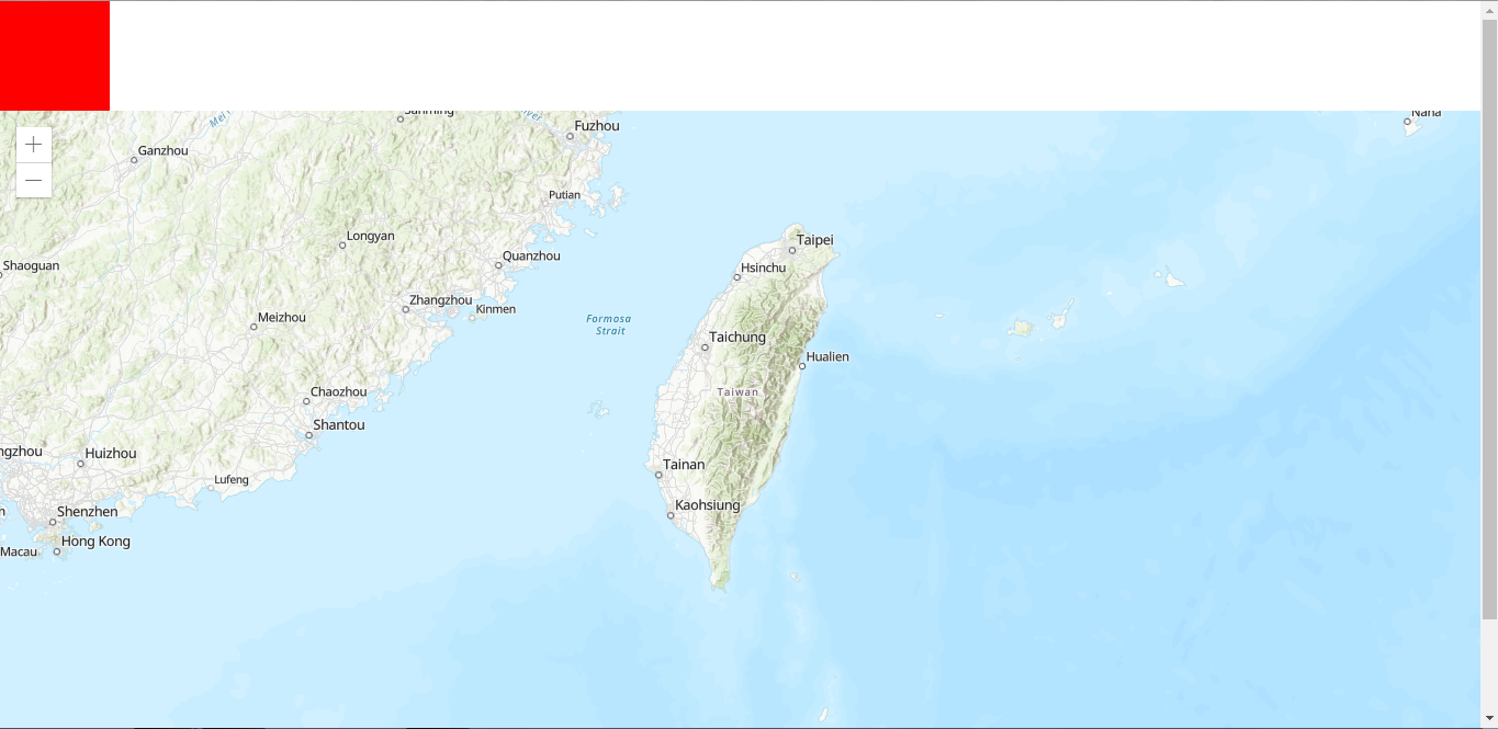

I have a div that I want to put inside the map, but either placing 'sidePanel' outside or inside 'viewDiv' don't work. I'm curious about is there any approach other than customizing a widget with TypeScript and SASS? To be specific, is it possible to do those widget tricks with generic HTML and CSS like I'm attempting?
my code :
Snippet
<style>
htmlbody,
#viewDiv {
padding0;
margin0;
height100%;
width100%;
#sidePanel  {
background-color:#f00;
height100px;
width100px;
</style>
Snippet
<div id="sidePanel"></div>
<div id="viewDiv" class="esri-widget"></div>
screenshot :
RobertScheitlin__GISP
MVP Emeritus
AnneFitz
Hi Jerry,
The sample mentioned above is a great way to create a side panel if you are trying to place something next to your map. You can also put HTML elements inside of your map (like you would with a widget) by using
view.ui.add(yourDiv, "top-right").
See UI | ArcGIS API for JavaScript 4.12 for more information.
