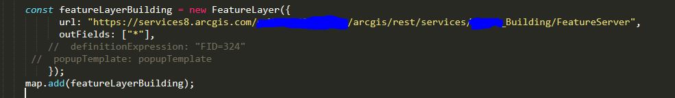

1 I add feature layer into the map.
Adding FeatureLayer to the map

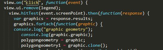

2 I took geometry on   event into a  polygongeometry1 variable.Taking Geometry of a selected Polygon into a polygongeometry1 varialbe

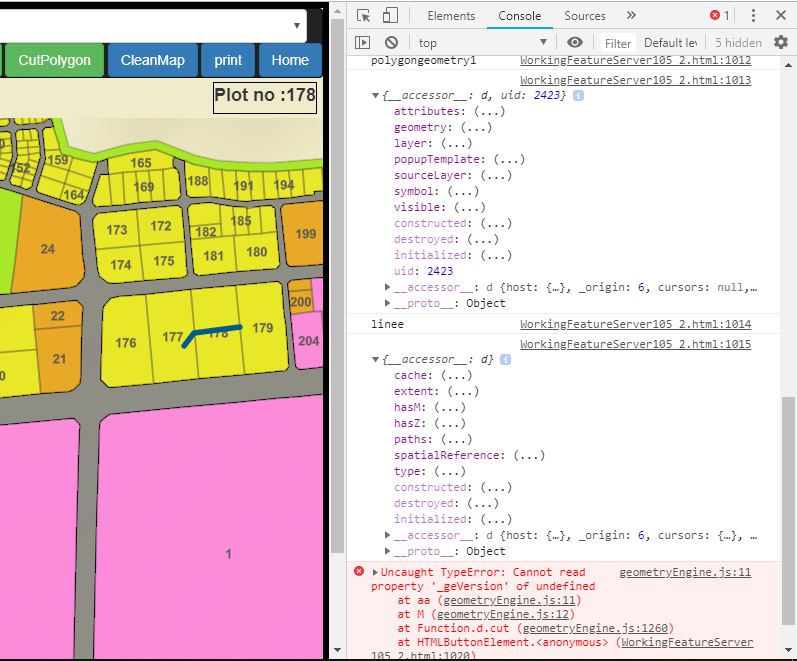

3 Then I draw a polyline with a draw widget and took its geometry into a linee variable. and pass it to a geometryEngine.cut method . but i receive this error
ge_version error
cannot read Property _geVersion of undefined although both polygon and line geometries are there.

   From your text and image it looks like you are passing the graphic and not the graphics geometry.
KristianEkenes
Yes. Be sure you are using a Polyline and a Polygon geometry for your inputs instead of graphics. The geometryEngine only works with geometries.
