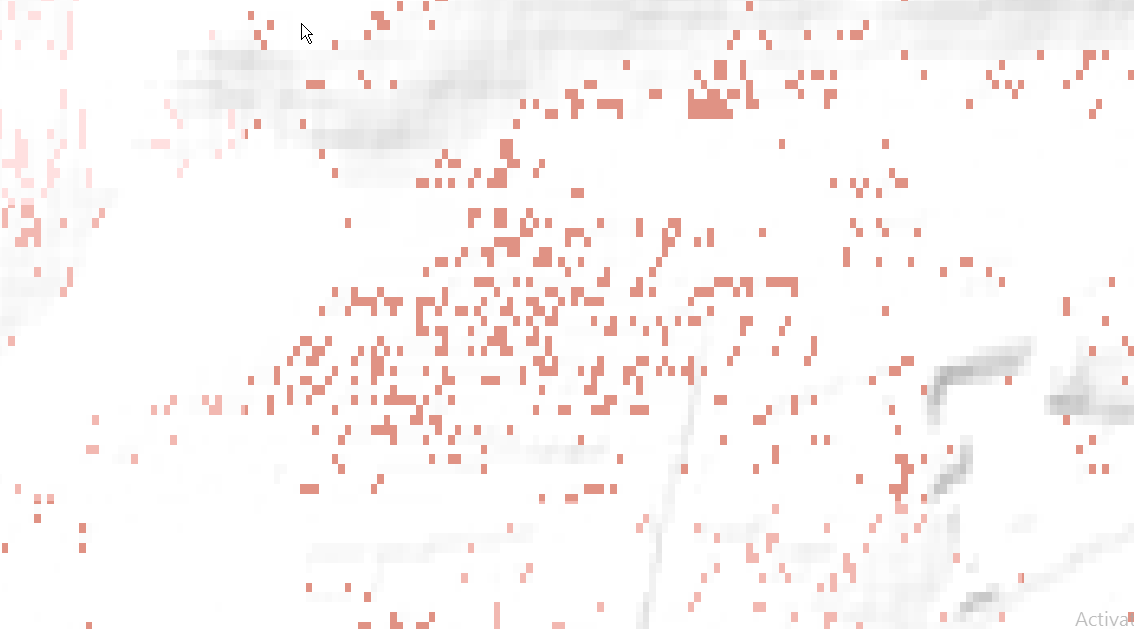

The hillshade visualisation have transparent pixels
1455
02-27-2017 06:15 AM
Pierre-JeanMuller
I generate the hillshade from the elevation then I publish it and view it using ArcGISDynamicMapServiceLayer. I got transparent pixels.In ArcMap, there is no problem, its only when the layer is visualised.
I tried to put white color on NoData pixels, but it doesn't work
Pierre-JeanMuller
To resolve the problem, I have to export it as a png image then publish it
Pierre-JeanMuller
