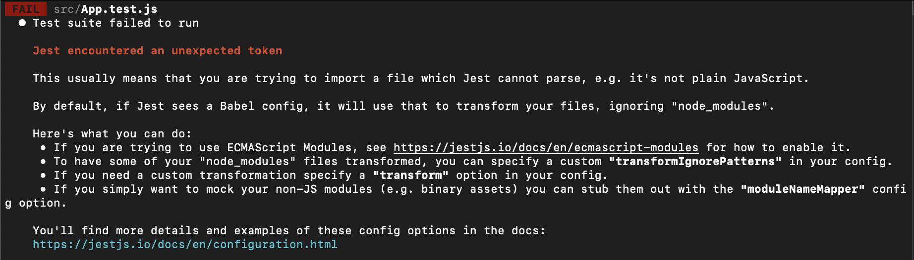

Hello all,
I'm encountering a weird error when I try to use Jest to test my react components which contain ArcGIS maps. I'm attempting to make a simple smoke screen test for a component which contain an ArcGIS map, but I always get this error from Jest saying "Jest encountered an unexpected token", meaning that Jest cannot read it. This error appears in every component with the arcGIS map in its ancestry. For example, I am getting an instance of the error from the App component because it's importing a child component which itself hosts an arcGIS map. I understand that ArcGIS uses Intern for its testing, but I'm not trying to test the source code, just the React components (which I wrote) where the ArcGIS maps live. I am using React 17.0.1, and I am using the @arcgis/core package (version 14.8.1) to make the maps. Can I get a second set of eyes on this? It's really T-Boning my tests 😕

Hi @craragon77 Try setting jest to ignore the @arcgis/core modules, for example: https://github.com/andygup/angular-jsapi-jest/blob/main/jest.config.js#L4

craragon77
Hi @AndyGup, that worked like a chart. I attached a jest object to the package.json file and pasted the content from the link you send into it. Thanks a bunch

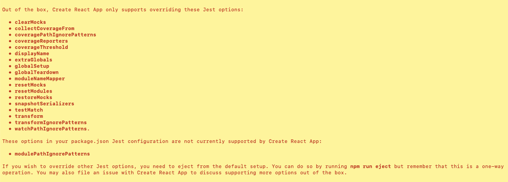

hmm, this is interesting. i'm trying to figure out how to enable jest to ignore esri and arcgis components. I attached this (see below) to the config file but i'm still getting the same error listed above (can't run test cause Jest encountered an unexpected token). I've also tried using other arguments in the config file, such as modulePathIgnorePatterns, but that breaks the testing framework because apps made with 'create react app' cannot use it (see screenshot). I think the issue will resolve itself once we can enable the testing framework to ignore the arcgis + esri node modules, but I can't figure out how to do it. got any tips?
"transformIgnorePatterns": [
      "node_modules/(?!@arcgis)",
      "node_modules/(?!@esri)"

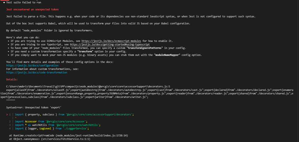

Hello,
Did you find a solution ? I have the same problem :
I am using the latest 4.21 version of the API. For the unit test, I'm using Jest with the ts-jest preset.
Here is my jest config :
"jest": {
    "preset": "ts-jest",
    "roots": [
      "<rootDir>/src"
    "testMatch": [
      "**/__tests__/**/*.+(ts|tsx|js)",
      "**/?(*.)+(spec|test).+(ts|tsx|js)"
    "transform": {
      "^.+\\.(ts|tsx)$": "ts-jest"
I tried the proposed solution above with the parameters "transformIgnorePatterns" but I still got the same error.
Any clues ?
