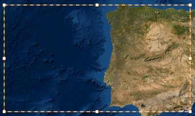

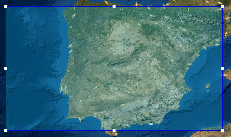

What i get:
I want something like this:
RobertScheitlin__GISP
MVP Emeritus
@JGraca,
Here is your codepen code updated for that:
MVP Emeritus
@JGraca,
If you want the polygon fill to be transparent then you need to set the fill style and if want the outline to be dashed then you have to set the outline style.
  polygonSymbol: {
    type: "simple-fill",
    color: [0, 0, 0, 0.2],
    style: "none",
    outline: {
      style: "dash",
      color: [255, 255, 255],
      width: 2
JGraca

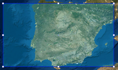

Hi, thanks @RobertScheitlin__GISP for the reply.
I have done what you suggested and it worked, but i would like to change the following:
- Remove the orange lines from the border;
- Change the boxes border colors to grey (the ones you draw on);
- Allow the polygon to be always resized;
On a different project, the background and the border still is with the blue colors.
On codepen it worked
MVP Emeritus
@JGraca,
