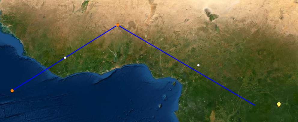

I am able to update the vertices of my Sketch graphic using the cursor, but am unable to do so programatically. Below you can see that when I change the location of a vertices of the drawn Graphic, the vertex changes, but the lines don't get redrawn to the new vertex location. Here is some sample code showing my attempt to modify the path of the graphic. Any help is much appreciated. I am using ArcGIS js version 4.21
I have noticed the difference when I am editing coords programatically is that the update complete listener with state === 'complete' and aborted === true, whereas when manually moving coords state === 'active' and aborted === false
UPDATE: I got it to work, using below code, but I don't think this is the recommended way of doing it. since graphic may not be found in sketch view model Would still appreciate alternative solutions.
