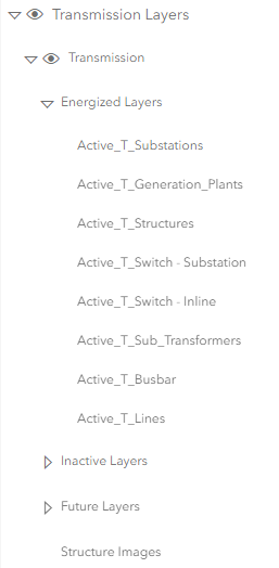

I am trying to pull in a MapImageLayer and show a LayerList that will allow users to toggle the visibility of the sub layers.  I was hoping to do it this simply:
require([
   "esri/Map",
   "esri/views/MapView",
   "esri/layers/MapImageLayer",
   "esri/widgets/Print",
   "esri/widgets/LayerList"
   function(
      Map, MapView, MapImageLayer, Print, LayerList
      myApp.myLayer = new MapImageLayer({
         url: "https://server/arcgis/rest/services/Viewer/Layers/MapServer",
         title: "Layers",
         visible: true
      myApp.map = new Map({basemap: "streets", layers:[myApp.myLayer]});
      myApp.view = new MapView({
        container: "viewDiv",
         map: myApp.map,
         zoom: 8,
        center: [-81.034814, 33.6],
      myApp.view.when(function(){
         var layerList = new LayerList({
         view:myApp.view
      myApp.view.ui.add(layerList, "bottom-right")
However, I have a bunch of sublayers within sublayers in this map service.  It's arranged like this:
  • Transmission
    • Energized Layers
      • Energized Substation
      • Energized Structure
    • Inactive Layers
      • Inactive Substation
      • Inactive Structure
  • Distribution
    • Primary
    • Secondary
  • Environmental
etc, etc.  I find I can toggle the visibility on the map service as a whole, or on the primary subgroup (Transmission, Distirbution, etc) But everything below that doesn't allow me to toggle....
Is there a setting somewhere that will let me do this? Or am I going to have to pull each and every one of these subgroups in individually??
