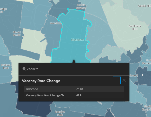

Hi all, I am trying to set the following popup docking options but the popup does not appear to be applying the properties correctly.
view.popup.dockEnabled = true;
view.popup.dockOptions = {
  breakpoint: false,
  buttonEnabled: true,
  position: 'top-centre'
As per the image, you can see that it places the popup in the top left corner and the pane is also sized too big for the content.

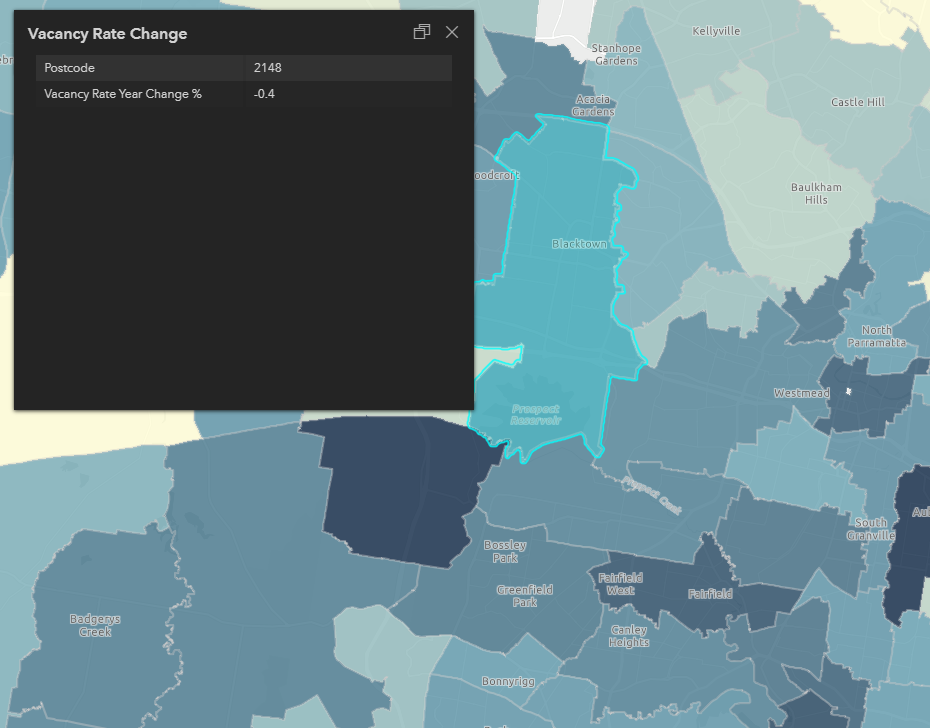

When I click the de-docking button, it places the popup in the default location, but now the dock button is missing, but the pane is sized correctly, as per the image.
If I remove the docking properties, then the popup displays correctly using the default properties i.e. top-right etc.
