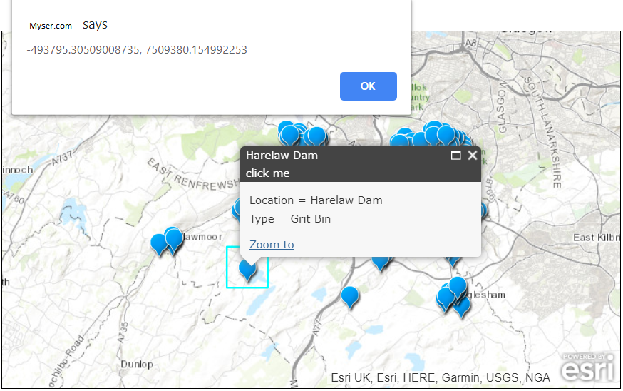

Hi, I have a map with multiple points, when i click on a point i get a pointInfoTemplate popup.  I'm experimenting with adding my own hyperlink into this popup.  So far, i've only been able to add the hyperlink into the title area which says 'click me'.  I would like to add the hyperlink below the header, somewhere in the content pane, is that possible?  If so, what could should i use?  I've copied the snippet below.

   In your code the only thing you are specifying in the InfoTemplate constructor is the title. That is why your link is appearing in the title.
var pointInfoTemplate = new InfoTemplate("item.attributes.LOCATION<br/><a class='clickMe' href='#' onclick='alert(item.geometry.x + \", \" + item.geometry.y);return false'>click me</a>");
If you add a second string parameter in the constructor then you will be specifying the templates actual content.
https://developers.arcgis.com/javascript/3/jsapi/infotemplate-amd.html#infotemplate2

ScottWilson2
Thanks Robert, i've managed to get it working.
