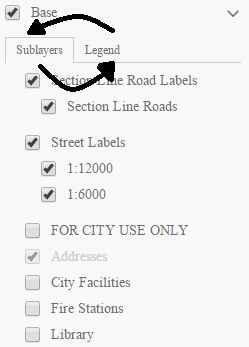

I have been working with the layer list widget and I really like it.  It is being used in several applications.  One thing I have noticed is that the sublayers appear before the legend by default.  is there a way to switch the order around?
Just curious if this is possible.  Thank you for any input.

Ian,
  Sure here is a sample that does just that:

IanPeebles
Thank you Much Robert!  I did look at the sample and the ordering is how I want.  I now just need to study the code to see how to re-arrange the order, but the sample you provided does just that.
