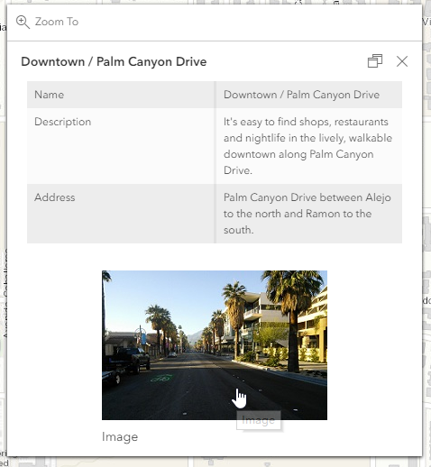

I'm making a map with images shown in popup. Because the popup is relatively small in size, I only show thumbnail of the image in popup. When user click the image, I'd like to show a full-resolution image. The popup looks like below:

By using "linkURL", I can put a link on the image inside popup. Is there a way to open the link in new window/new tab by default? Currently the link will be opened in place, which means that the map page will be redirected and user will not be able to access map page unless he/she click "Back" button in browser.
