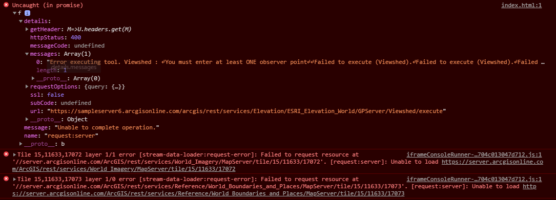

Hello JS API team,
Clicking anywhere on the viewshed analysis sample sometimes returns an uncaught promise error. You can replicate this by clicking on the North/South Pole. Additionally, several tiles fail to load.
This is on version 4.18 of the ArcGIS Javascript API:
https://developers.arcgis.com/javascript/latest/sample-code/geoprocessing-viewshed/
It seems that when the geoprocessor executes the parameters and promises to draw the result data, one of the parameters doesn't get passed...
var params = {
  Input_Observation_Point: featureSet,
  Viewshed_Distance: vsDistance
gp.execute(params).then(drawResultData);
