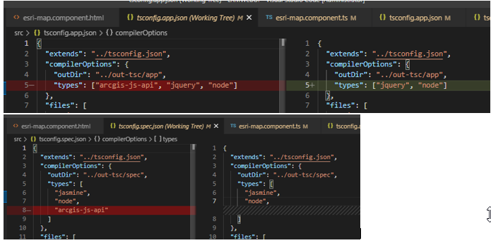

So, I tried remove “arcgis-js-api” from “types” in tsconfig.app.json and tsconfig.spec.json.  It now compiles.

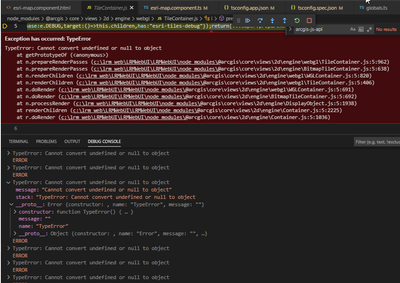

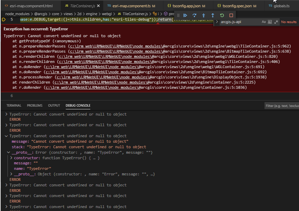

However, when the map is being loaded, it hits a series of “TypeError:  Cannot convert undefined or null to object” and gives an empty map with no layers.

When using the npm packages for @arcgis/core or arcgis-js-api, you don't need to install the typings separately. They packages already include them.
As for the second error, tough to debug without a repro sample to look at. Could be an issue that the element you're using for the map container isn't ready or something else.

Thanks Rene.  Do I need to uninstall the typings which I have installed separately?  Is it correct for me to exclude “arcgis-js-api” from “types” in tsconfig.app.json and tsconfig.spec.json?
ReneRubalcava
Esri Frequent Contributor
You can uninstall the typings and you don't need to reference them in the tsconfig files.
The tsconfig in the TypeScript guide is a good reference https://developers.arcgis.com/javascript/latest/typescript-setup/#tsconfig
Although it assumes you are using the CDN and need the typings, but still no reference to them in the tsconfig.
The same goes for building an app with webpack as well.
https://github.com/Esri/arcgis-js-cli/blob/master/templates/webpack/app/tsconfig.json
SteveBurdette
Did you ever figure the second issue out?
I'm having the same problem but only when I publish my application and not on development.
