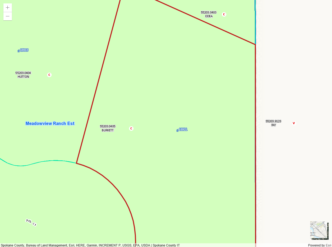

Here is my zoomed map with the code above -- as you can see, it's not showing the full extent of the polygon I need to have zoomed into:

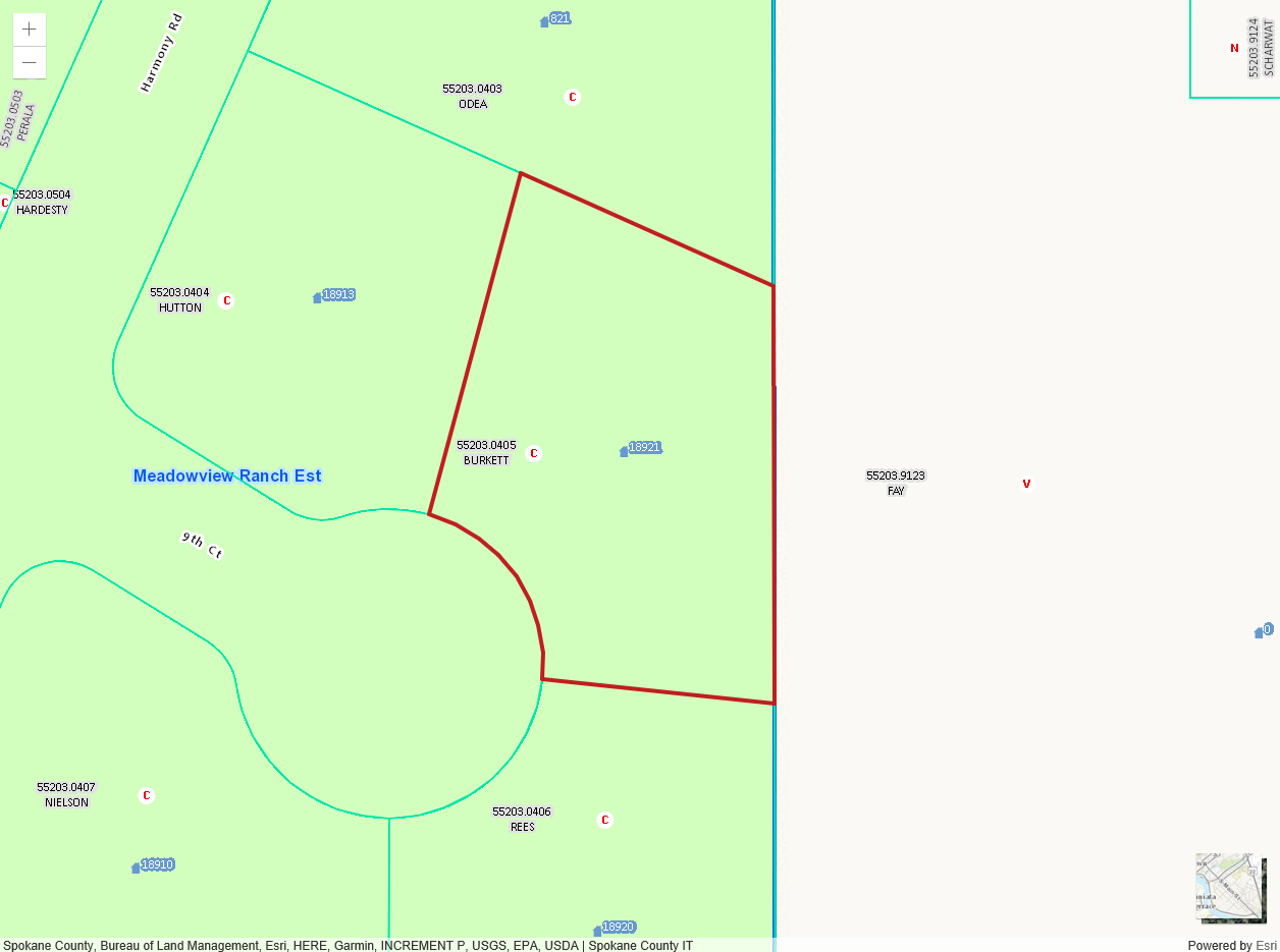

Here is a more preferable view one click zoomed out (though I'd rather have the polygon fill the space, but be completely visible in the map):
