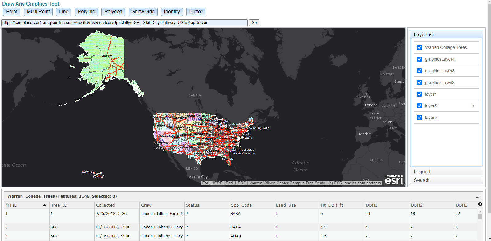

This is my code  please do help me to create a buffer on click on map and to highlight the features across that distance(eg:5km).

Steffi,
   In your activateTool function you just need to handle the buffer button.
  function activateTool() {
    var tool = this.label.toUpperCase().replace(/ /g, "_");
    if(tool === 'Buffer'){
      //goto your buffer function
    }else{
      toolbar.activate(Draw[tool]);
    map.hideZoomSlider();
SteffiAntony
can you please provide me a sample code for buffer functionality???
RobertScheitlin__GISP
MVP Emeritus
          var Buffers = geometryEngine.geodesicBuffer(Point20"meters"true);
          Buffer = Buffers[0];
