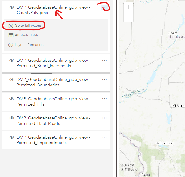

I am trying to implement an action that zooms to layer's full entent. Is there a way to access the related layer?

For instance, I am trying to access the layer shown with the arrow mark when actions (3 dots) triggered

The LayerList doesn't have a layer property. You'll have to get the layer information from the event.
view.goTo(event.item.layer.fullExtent);
However, this will only work with single feature layers, not Group Layers, as in this sample
