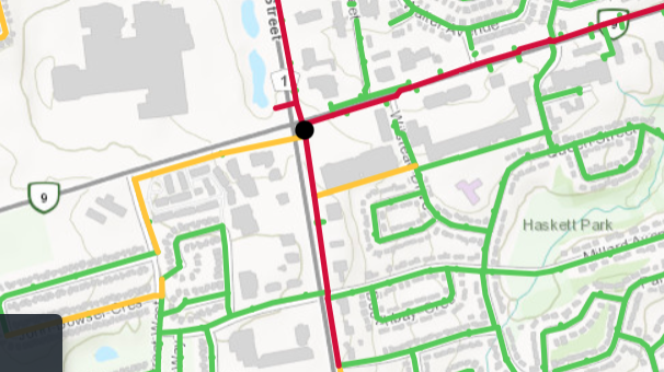

I have a map with many layers on it, when I turned off a layer by setting opacity to 0 in the feature query:
if (featureQuery.length > 0) {
this._view.whenLayerView(this._layers[prop][innerProp]).then((featureLayerView) => {
featureLayerView.effect = {
filter: {
where: featureQuery
excludedEffect: 'opacity(0%)'
} else {
this._layers[prop][innerProp].visible = false;
the layer disappears, but I'm still able to select the feature, the circle is not visible on the map
I'm using ArcGIS Core 4.20.2, I'm doing a hittest to pick up the feature clicked, is there away to filter out features which aren't visible, or have an opacity of 0?
